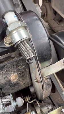

            No choking does not help. Ether while it is running makes no change. Did the carb cleaner test around the intake gaskets to look for a leak, none found.
            I did find the spark plug on the drivers side cylinder looks like it has a smaller spark kernel, not as hot of a spark. Cleaned the plugs and traded them, still the drivers side cylinder looks like a weaker spark. Possibly a coil?

              I forgot, I re-adjusted the valves. Compression now is just under 100 on both cylinders. My compression gauge is old and has been beat around the race track a lot so it may not be exactly accurate.

                                                        I started the day dumping about a teaspoon of gas in each cylinder then trying to start the engine. It cranked a little bit then started. It will run on low idle but falls flat when accelerating. After it warmed up a little I could slowly bring the engine speed up. I shut it off a few seconds and started it again, it did start but ran the same. Pull the choke and it dies out.
                                                        found my good compression gauge, both cylinders are at 120 psi.
                                                        I will attach videos of it running. Possibly the high idle circuit in the carburetor is blocked.
