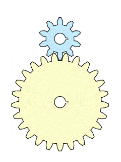

                          The steady click does indeed sound like its coming from the larger gear based on the video. Everything else is moving way too fast. Bearings typically make a "marbles" sound or grinding noise rather then a steady knock, maybe check to make sure the gear is not out of round. Maybe a previous owner bottomed out the differential causing that minor imperfection. I would hate to see you replace the gear and still have the same issue. You can try spinning it by hand to observe the movement when it is installed with the pan off. As you can see from this animation, everything else in there is just moving too fast to create a steady knock.
